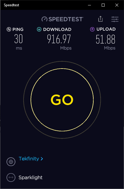

OK up and running. I recommend doing a full on factory reset and setup from scratch. Saw a odd problem with some devices not listed or seemingly being connected in the RBRs connected devices page. Factory reset cleared this out and now all devices are displayed and connected. Also RBS didn't want to re-connect wirelessly after the update. It connected if I ethernet connected the RBS to the RBR. After the reset and setup from scratch, RBS connected wirelessly successfully. Will be ethernet connected in it's remote location.
Wired speeds are good while connected to a CBR750 in bridge mode:
