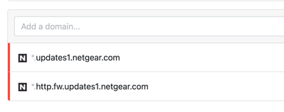

- jordandMay 10, 2022Star
For anyone wanting to block automatic upgrades from Netgear, it's fairly simple if you have the right tools to do it. Note that the following guide only applies for people like myself who have an ISP router without the capability to block websites. You could always follow these instructions on your ISP router if it works for you.
Simply use a DNS blocker like pihole on a Raspberry Pi, or a service like NextDNS.io. Set your DNS under the Internet configuration to either the Pihole or NextDNS. You can use the no-ip functionality to ensure NextDNS always has the right IP address of your home to identify your traffic.
Add the following wildcard addresses to your blocklist. This will stop the router from communicating with the update server(s).
For added peace of mind, you could also use Netgear's parental blocking feature to block http.fw.updates1.netgear.com as well. You can never be too sure!
My system has not automatically updated since I've done this. I'm on v3, though!
