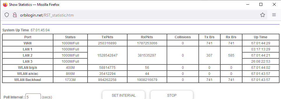

Sep 17, 2023Aspirant
Hello i know what is the problem, in the statistic, the connection between rbr and rbs is only at 100M .
Beforce the update with the same configuration (cat7 rj45) is was at 1000m .

- FURRYe38Sep 17, 2023Guru - Experienced User
I would bring the RBS to same room and the RBR and connect the RBS to the RBR while in same room wirelessly first. Test and check stats. Then ethernet connect the RBS to back of RBR using good quality CAT6 cable. Check the stats on the RBR. Should see 1000Mbps here.

- TheobuckSep 17, 2023ApprenticeIs there a KB for’ Check the stats on the RBR. Should see 1000Mbps here.’? Or how does one check this?
- CrimpOnSep 17, 2023Guru - Experienced User
On the Orbi web interface, Advanced Tab, home page, click on Show Statistics:
This screen show is from my RBR50:
