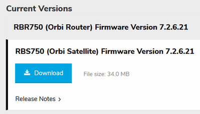

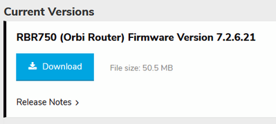

- CrimpOnOct 09, 2023Guru - Experienced User
I downloaded them myself
First this one:
Then, this one:
Just did it again to double check. Both "Download" boxes result in the same file being downloaded.
- FURRYe38Oct 09, 2023Guru - Experienced User
I see, the BLUE DOWNLOAD button is linked wrong for the RBS.
You can get the RBS from this link:
https://kb.netgear.com/000065815/RBR750-RBS750-Firmware-Version-7-2-6-21
I'll notify NG about this
