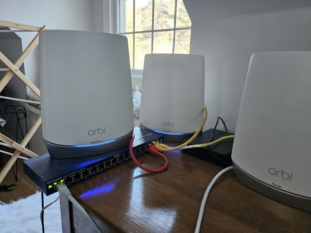

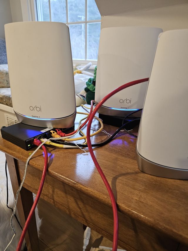

I tested this with an unmanaged Netgear GS116 switch. I had the two Satellites and the Router connected to the switch. The backhaul failed just like going through the managed switch. The Satellites show connected but the Router doesn't recognize them.
This picture appears to show the router being connected to the switch using the WAN port. Orbi routers will not detect a wired connection to satellites through the WAN port. The firmware "knows" that satellites only appear on the router LAN ports. It's how the firmware works.
- FURRYe38Jan 22, 2024Guru - Experienced User
When in AP mode, the RBR should be using its WAN port connection to the host router. The LAN ports need to be connected to the switch and then the RBS connected to the switch.
- ducs4rsJan 22, 2024Tutor
I have the RBR WAN port connected to the routers LAN VLAN via a switch. The RBS' are on the same VLAN. Why do you need a dedicated connection from the RBR to the Opnsense router? Not sure how I would set this up.
RBS will connect and be seen by the RBR if you have the following connection path configuration with out any VLAN.
Host Router<>to WAN port on RBR<>GS series non managed switch connected to LAN port on RBR<RBS ethernet connected to the GS switch.
I've never configured any VLAN configurations so no sure how this could impact your system and how Orbi and the RBS ethernet connect to the RBR while in AP mode. I do know that the above configuration path does work and works well, even in AP Mode.
The picture (thanks for posting that!) appears to show a white cable going into the switch. (is that from the OpenSense router?) Perhaps connect the white cable to the Orbi wan port and run the orange (red?) cable from a router LAN port to the switch?

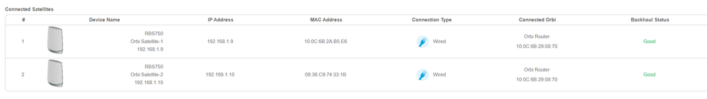

I got it sorted out thanks to this post. I created a backhaul vlan on a managed switch. The WAN port is VLAN'd to my home network to reach the Opnsense router. I created an isolated VLAN for the backhaul network and connected the RBR, RBS's LAN ports. It all works like a charm. Thanks for all the pointers and discussion. Sorry it took so long.
