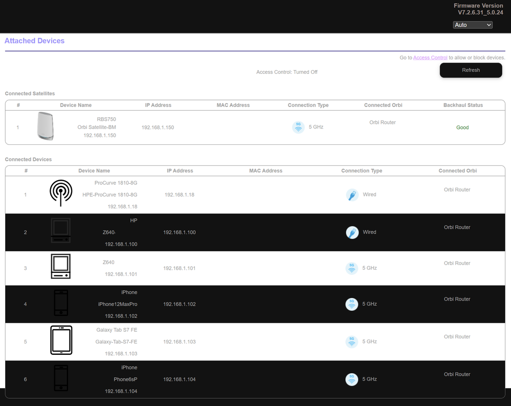

Ok, RBK752 is online with v.31:
Mixed Mode WPA2 and WPA3 enabled.
WiFi Protected Address disabled on both phones and the pad.
Two different iPhones connected.
iOS 15.8 and 16.5 here.
Windows 11 PC on 5Ghz using BE200 PCI adapter:
SSID: RBK752
Protocol: Wi-Fi 6 (802.11ax)
Security type: WPA3-Personal
Manufacturer: Intel Corporation
Description: Intel(R) Wi-Fi 7 BE200 320MHz
Driver version: 23.10.0.8
Network band: 5 GHz
Network channel: 48 - Foo42May 16, 2024AspirantInteresting. Thanks for taking the time to try it out!
