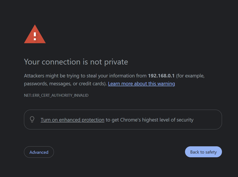

Using Chrome here as well with my 850 series, I get the following when I enable HTTPS:
- CrimpOnMar 17, 2025Guru - Experienced User
I get that notice with Chrome as well when using http (not https) We are able to turn off that "always use secure web" option. When I DO enable the option, noting happens to attempts to open web sites.

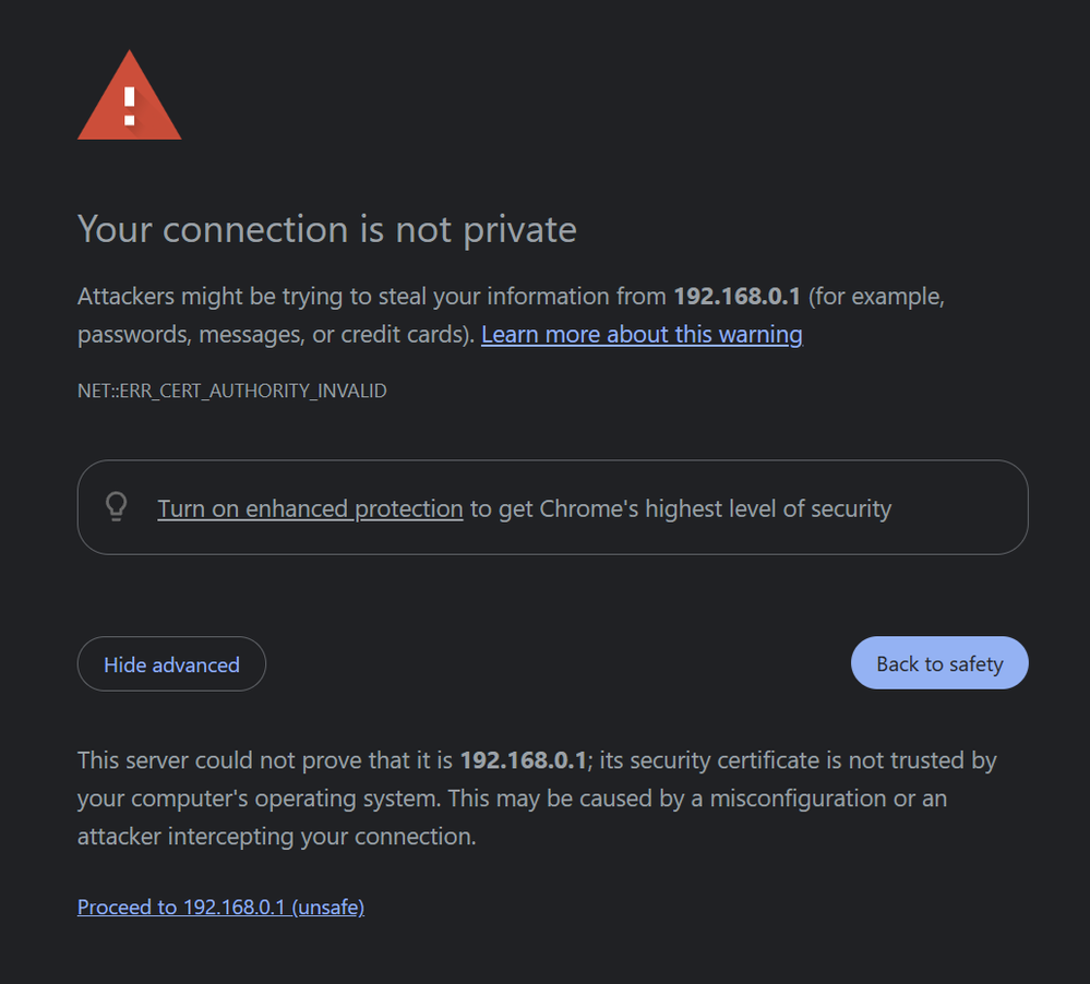

This is most strange. Using the latest Safari, the checkbox was selected and when I went to deselect it and clicked on Apply, I got the error message warning about entering an unsecured website and to proceed with caution. I logged out instead and tried the latest version of FF. I was able to select/deselect the box but didn't attempt to Apply. I logged out, went back to Safari, deselected the checkbox, clicked on Apply and this time I didn't get any error message and the change was saved. Logged out, went to FF to check and the box was now deselected. Back to Safari and it was still deselected.
So it appears now that I have successfully deselected the checkbox but I don't know what the advantage is of selection/deselection, or how I was able to do it. I still have issues at times when clicking on Search links (Duck Duck Go or Google Search) but it is hit and miss.
- CrimpOnMar 18, 2025Guru - Experienced User
Which option is enabled determines which error message some web browsers will display:
- Using http (not encrypted) web access will cause an "unsecure" warning because the conversation between web browser and web host (the Orbi router) is not encrypted. Most of us choose to ignore this warning because both our web browser and the Orbi are on the same home network. In my case, my PC is wired directly to the Orbi router. How is anyone going to 'snoop' on this connection?
- Using https (encrypted) web access will cause a warning because the SSL certificate on the router is "self-signed".
Many web browsers remember when the user tells them "ignore this stupid warning and proceed to this web site anyway." Other web browsers either throw up the warning every time or simply refuse to proceed. Annoying as hell.
