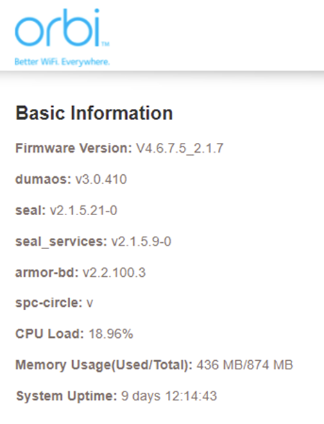

- FodenFeb 10, 2022Apprentice
I don't use IP6 but turned it on to see if I would see any memory leak. Over the last 2 days or so it won't from 431MB down to 415Mb when I turned it on, now running at 436Mb
Not sure why system isn't uploading my screenshot
- FURRYe38Feb 11, 2022Guru - Experienced User
Keep us posted on your memory usage. Would like to see what happens if it get near max value.
