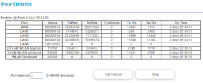

So here's a strange observation, something that isn't causing any direct problems but might possibly help to inform other things that are going on? Firmware version 4.6.8.5 here.
I'm looking at the Advanced / Statistics display on my Orbi router. It appears the LAN ports are periodically resetting themselves in terms of their uptime.
So my system has a current uptime of 7 days 15 hours. The uptime on the router and both satellites matches that, according to their various debug pages. On the Statistics page, the WAN port, the two WLAN entries and the WLAN backhaul also show 7 days 15 hours. But the LAN ports (1,2,3,4) all show an uptime of 3 hours.
Yesterday evening when I checked them, the LAN ports had an uptime of 90 minutes. So they have "reset" at least twice in the last 24 hours.
The system hasn't rebooted itself and indeed this doesn't appear to be causing any issues with connectivity at all. At the time the "reset" happened yesterday evening, we were watching a streaming movie with the TV connected via one of these LAN ports. So it did not cause any interruption in the connectivity.
It's a strange one and I'm not really concerned because it isn't causing any issues but I thought I would flag it here in case it helps with debugging or other issues identified with this firmware.
- FURRYe38Jul 03, 2022Guru - Experienced User
Interesting.
What is connected on the LAN ports?

- GarwoofooJul 03, 2022Apprentice
LAN ports are as follows:
LAN 1 - Hue lights base station
LAN 2 - a Netgear Wifi extender (WAC104) which sits in a garden office completely separate from the main house; there is no overlap between the two wifi networks
LAN 3 - not used
LAN 4 - a Netgear switch to which is connected multiple entertainment devices (TV, games consoles etc) plus a wired Orbi satellite
I don't think the "reset" is connected to activity on the LAN; I've seen this reset when the ports are in use (watching a streaming service) but also in the middle of the night when there would have been nothing more than background activity on the network. I've also seen it stay up for nearly 30 days without problem! All WAN ports "reset" at the same time.
As I say, it's a curiosity rather than a problem, as it doesn't appear to actually be affecting anything, but I'm curious to know what's happening.
FWIW I also observed this behaviour on the last firmware version (4.6.8.2) and was going to post about it then, however 4.6.8.5 came out and I've been monitoring it since then to see if it reoccurred. It was fine for 7 days following the upgrade, then two "resets" in 12 hours, now appears to be fine again. Network otherwise seems entirely stable.
What is the model# of this switch?
Wondering if you have seen this on other FW versions, possible something on your network could be a cause.
Gather how often this happens if you can monitor this...

- GarwoofooJul 04, 2022Apprentice
FURRYe38 wrote:What is the model# of this switch?
It's an 8-port Netgear GS308 switch.
I'd be quite surprised if it is anything on my network - as I said, I've seen this occur during the day but also in the middle of the night when network activity would have been minimal. Also it seems to be rather random, sometimes going for weeks without occurring and then sometimes more than once a few hours apart.
I'll keep monitoring and let you know if I detect any pattern to it.
- FURRYe38Jul 04, 2022Guru - Experienced User
K. I have this same model switch though its at the end of a segment.
We might be looking into this more closely....

- GarwoofooJul 10, 2022Apprentice
FURRYe38 wrote:We might be looking into this more closely....
Just updating you on this - the system went over a week without issues, then I can see that the LAN ports again did a "reset" early this morning. At the time, network activity would have been minimal.
As before, this seems completely random, and didn't cause any issues when it happened. I'm treating it as a curiosity more than anything.
I am however seeing evidence of occasional reboots of my wired satellite, every few days or so, just going by the uptime on the debug page. This is more concerning. It doesn't appear linked to the LAN port resets. And I didn't see any spontaneous reboots of the satellites at all under 4.6.8.2. So I am monitoring this one closely.
- FURRYe38Jul 10, 2022Guru - Experienced User
Ok. Are there any collisions seen on the Statistics window on the RBR?
Do you happen to have a different model or brand LAN switch laying around?
- GarwoofooJul 11, 2022Apprentice
FURRYe38 wrote:Ok. Are there any collisions seen on the Statistics window on the RBR?
No collisions shown. I've never seen any collisions at all on this screen at any point.
I don't have another LAN switch lying around - however I did realise last night I have a redundant LAN switch in my configuration. One of the LAN ports on my Orbi has a Hue Lights base station connected to it, at least so I thought but it turns out the Hue base station is connected to a 4-port Netgear switch which is in turn connected to the Orbi. It's the only thing connected to that switch and it's left over from a while back when I had more items connected - I never got around to taking it out.
I'll remove that when I get the chance and see if it make any difference. It's only a 4-porter so not suitable for replacing my existing 8-porter but maybe it'll help.
- FURRYe38Jul 11, 2022Guru - Experienced User
