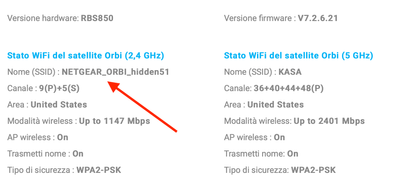

Update went smooth but after 2 days had to shut down satellite because it won't let clients get an IP from DHCP server. RBR and RBS are in AP mode (wired) and were running fine since February 2021. Router is a draytek vigor 3910.
What is the best way to factory reset a RBS? Found the thread with the procedure regards
PS. RBS started also broadcasting ORBI51_HIDDEN network

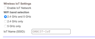

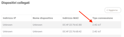

Does someone have a clue where the satellite get's the 2.4 SSID name?
Devices are recognized AS 2.4 IoT
But 2.4 IoT is disabled on RBR
Regards
- CrimpOnSep 11, 2023Guru - Experienced User
That screen shot clearly shows the IoT network enabled on 2.4G and 5G.
Totally "MY BAD". Yes, the IoT network shows as disabled
- FURRYe38Sep 11, 2023Guru - Experienced User
Try changing the SSID name of the IoT network to RBK850-IoT
