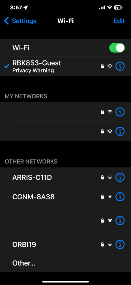

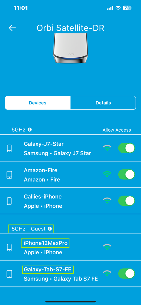

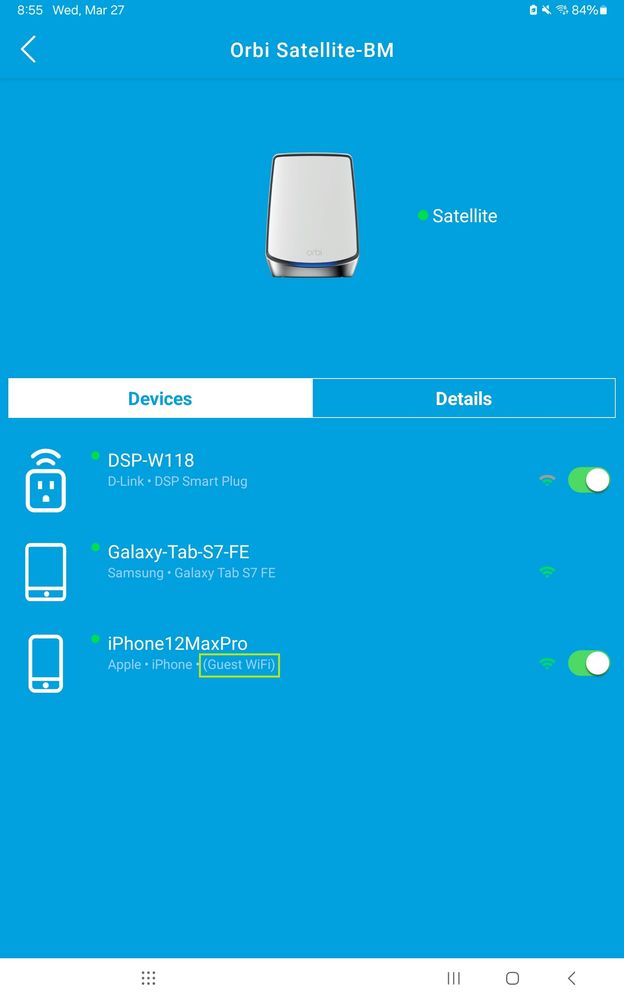

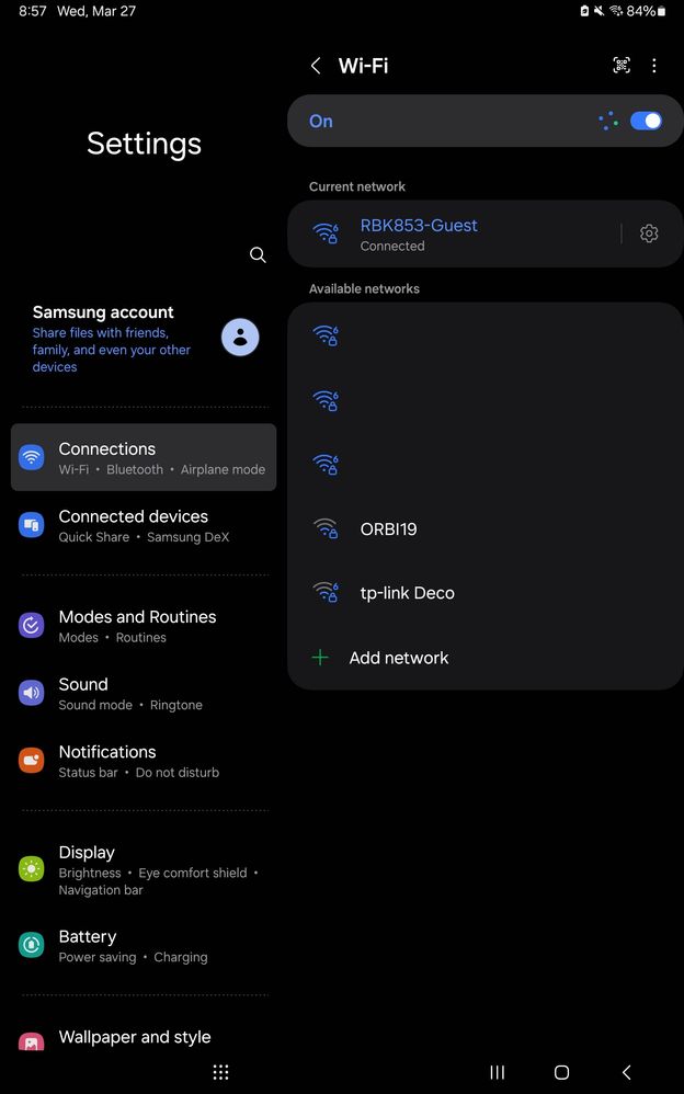

Ok so I had a quick chance to check Guest Network on a 850 series last night. Both RBS are ethernet connected. One, in the basement is connected behind 3 non managed switches, the other is connected to only one non managed switch. Guest network was not enabled so I just logged in to the RBRs web UI last nite and enabled it. Used default GN password as I don't normally use Guest Network so password is default that NG sets.
Both iPhone 12 Pro Max (iOS 16.5) and a Samsung Galaxy Tab S7 FE (OS 14) connected and got internet over the GN. I presume if there was a problem, the status on each would let me know if there was no internet access, however both reported not having any internet issues. MAC address randomizers are disabled on both as well.
Orbi app showed them connected as well on Guest Network:
I connected both devices to YouTube and streamed some videos with out any problems.
RBR is connected to a CM3000 using the Multigig port.
RBR has been online for past 14+ days as I've been testing for CPU usage creep with RBS ethernet connected.
Guest Network is working here on my system. I'll leave it enabled thru the weekend and check it here and there as I get time.
