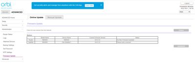

I received my new Orbi RBK852 today and after I had set it up, I manually updated the Satellite and then the Router to firmware 4.6.3.9. Overall no issues experienced other that two items below:
1. While my RBR850 Router shows firmware 4.6.3.9 in the Router Information, it displays V3.2.18.1 in the top right of the browser window.
2. Eventhough I had never switched on the Guest Network, and in the settings it was showing as Off, I could see an unprotected Netgear_Guest showing on my iPhone available WiFi networks. Unfortunately while I have a screen shot of the Router settings to show the Guest Network is switched off, I didn't get a screenshot from my phone showing the unprotected Netgear_Guest network being in the list. I proved it was from this router by renaming the Guest Network to Netgear_Potato and adding WPA2-PSK security, while keeping it switched off, and I saw it listed on my iPhone with a secure symbol.
Unfortunately I can't see it now, but it is a little worrying if I hadn't noticed it that the router was making the Guest Network available.

- FURRYe38Aug 18, 2021Guru - Experienced User
Be sure to clear out all browser caches.
Try the RBRs web page with a different browser to compare...
Did you power OFF the RBR and RBS for 30 seconds after updating FW?
If you saw this while the RBR was getting to ready, i maybe online for a few seconds then turning back OFF...You might factory reset the RBR and Setup from scratch to see if this clears this...I believe I saw this once as well...I have not seen it again.
