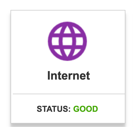

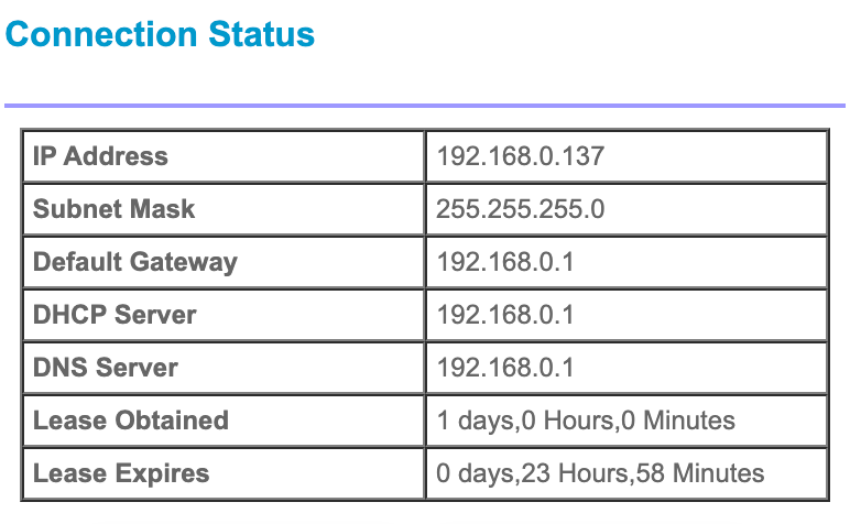

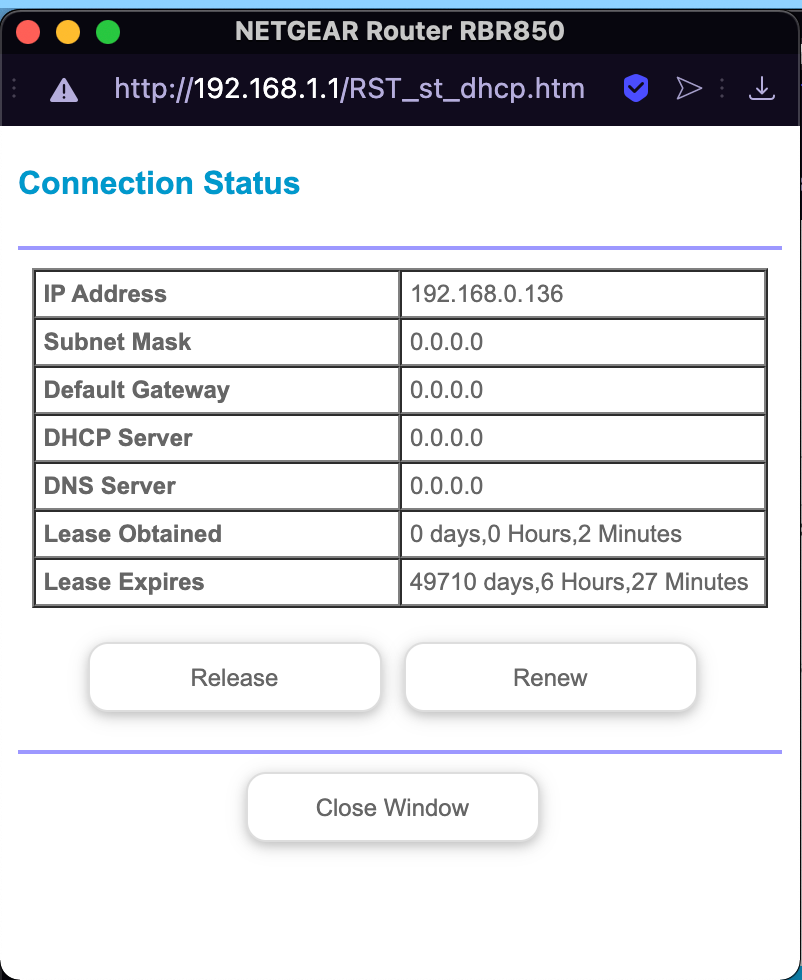

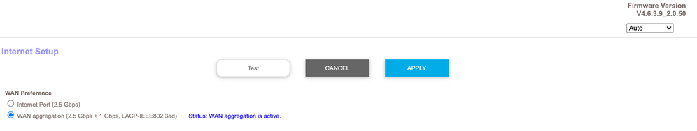

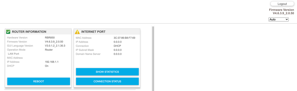

I tried mine with v4 in WAG mode with my CAX80. RBR preconfigured with WAG enabled then shut off. Configured my CAX80 for LAG and it rebooted. Powered ON the RBR while the CAX80 rebooted with LAN cables connected.
I noticed also it didn't seem to connect in WAG mode or get an IP address from my CAX80 with it's LAG enabled after both units were ready:
I then figured I'd select the RELEASE and RENEW buttons. I gave it several seconds. I checked the front LED and it was PINK. I when back and checked the status connection and it finally got a connection:
Basic tab reported GOOD:
WAN Prefferences reported WAN Agg was Active:
Try RELASED and RENEW on the RBR Status page.
