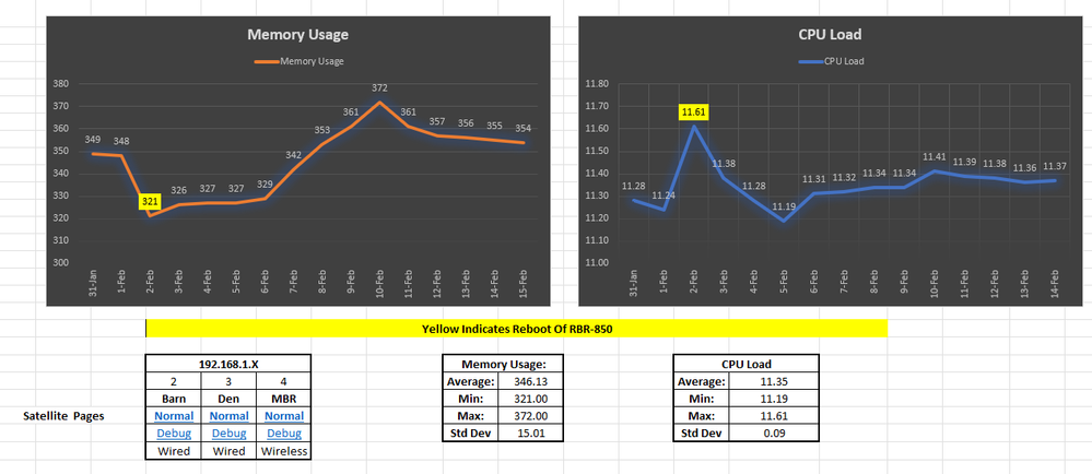

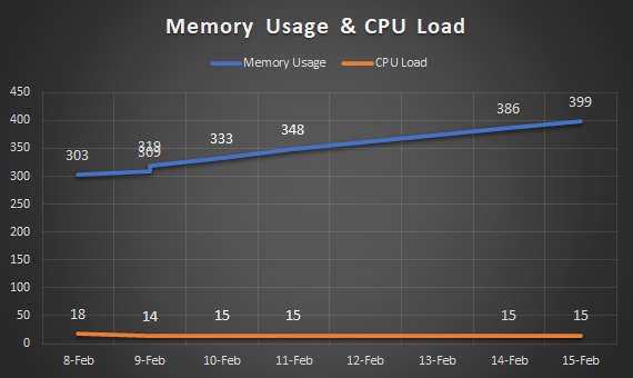

So still seeing memory creep. Slowly creeps upwards. CPU seems stable while in AP mode though:
- Chuck_MFeb 15, 2022Mentor
Memory usage peaked on 10 Feb and continually fell without explaination or reconfiguration.
- tjtrimbleFeb 15, 2022Luminary
MIne dropped to a low of 612MB late Sunday night (From a high of 710MB last week) and it started creeping back up yesterday. Right now, its at 625MB. I would love to know what is utilizing the memory since all logging is turned off.
