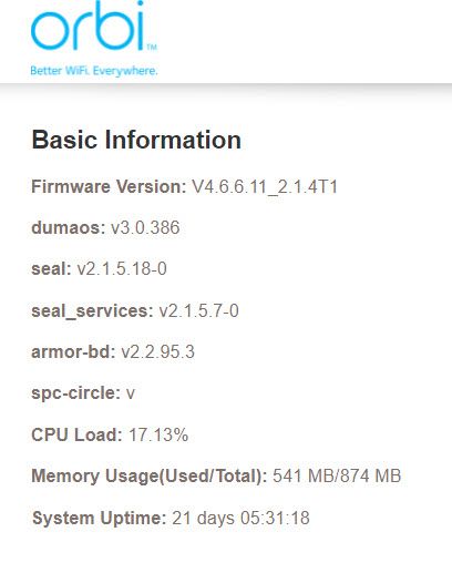

I agree, 4.6.6.11 has been rock solid for me. The only question I have is about the memory usage....seems to be always using more and more. It started out using about 300MB and has grown about 10MB a day. I'm not sure if its something I need to be concerned about.
