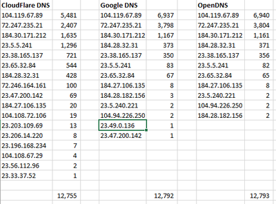

Back in June, I used Wireshark to capture network activity from a test RBR50 that is connected to the local network and had no devices connected to it. (nothing at all) This was intended to ensure that the only network traffic being captured was from the router itself and not from anything connected to the router. Wireshark captured an interesting set of conversations. Here's one of my records showing how many characters were sent and received by this router:
This shows the router contacting Netgear at 1:12 every morning and 14:49 every afternoon. HTTPS packets are encrypted, so I was unable to see what was going on. However, the pattern is exactly the same. Send a packet with 144 characters, get back a packet with 189 characters, etc. etc. At 1:12 the router makes six requests of http.fw.updates1.... and gets back a variety of information. Those asterisks (*) indicate that the DNS request from the router resulted in a different IP address for the update server. For example, on June 12 I recorded:
01:12 23.5.5.241 146 575 104.119.67.89 174 ????? 23.55.241 144 189 23.55.241 144 189 23.55.241 144 7504 104.119.67.89 143 181 Netgear uses a huge number of IP addresses for http.fw.updates1.netgear.com. I wrote a script to ask CloudFlare, Google, and OpenDNS to resolve http.fw.updates1.netgear.com over and over, and this is what they said:
I have no idea why Netgear uses so many different IPs for the resource, or why CloudFlare, Google, and OpenDNS vary so much.
