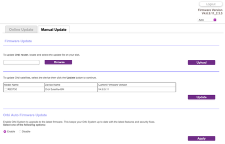

Basic and Advanced are the two tabs at the top of the page ORBI page accessed via direct IP address - image attached
I'm not having any issue with this - Others posted about the guest wifi being on when they had the box unticked (off) - I mentioned this as I was able to create a scenario with guest wifi on when it should be off - AND how it happened in the hope it may be of use to those trying to replicate the issue and resolve.
