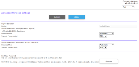

- FURRYe38Nov 11, 2022Guru - Experienced User
Going on 10 days of good uptime on the 9 series in AP mode thats connected to a XR1000 router and a CAX80 modem:
RBS are ethernet connected to the RBR using 2.5Gb ports with XS505M and GS110MX in between them.
