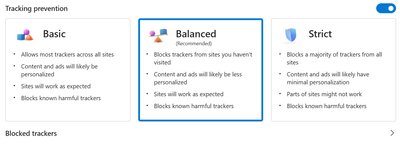

- bullm00nMay 20, 2024Virtuoso
My bad - "RBKE..." - forgot about that "E".
On the manual update, the only thing I did do differently on the 3rd try for the RBR960 was set tracking prevention temporarily to "Basic" on the browser rather than "Balanced":
Not sure why that would matter, or if it was coincidence... 🤔
- FURRYe38May 20, 2024Guru - Experienced User
What browser are you using? I use MS Edge and my system took on first load.
Edge Beta - could be that or could be that tracking setting I changed.

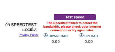

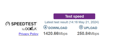

- bullm00nMay 21, 2024Virtuoso
Download speeds have been hampered since I updated. And sometimes the Orbi app or Router browser page gets a slower result than I do directly with Speedtest from my computer or iPhone.
I just rebooted the Xfinity XB7 and Orbi and it seems better although I'm still get intermittent odd results with the speed test even telling me it "cannot detect bandwidth" from the browser:
And seconds later it will work:
So, there's something glitchy with this update I have never seen before. It could just be an issue with the way Speedtest is working now from the Orbi since the PC/Phone results don't agree - I don't know.My gut is telling me to roll back to .21 as it was working fine. Maybe the issue that many others are seeing with Xinfity/Orbi is now manifesting for me or Speedtest is wonky in this build.
I also noticed some odd network drop outs last night. But with Xfinity, I often don't know where the fault lies.It works well enough that I can leave it and keep an eye on it for a day or so, but I'll likely roll back if this continues.

Enjoy. 📡 - bullm00nMay 28, 2024Virtuoso
bullm00n wrote:My bad - "RBKE..." - forgot about that "E".
I can confirm that this setting in the Edge Browser, beta at least, will block the RBR firmware update. Sats are fine with it, but it must be set to "Basic" for the RBR.
I had rolled back to troubleshoot some Xfinity issues (degraded speed after several hours) and now that they persist with the old firmware too, I have updated again and this same "goes through the motions, reboots, not updated" thing happened again.I reckon Xfinity are messing about the network again. Xfinity upgraded the DL speed to 2GB, but it eventually drops to around 400Mbps and requires an X7 reboot to get it back. As best I can tell, it's no fault of the Orbi.
