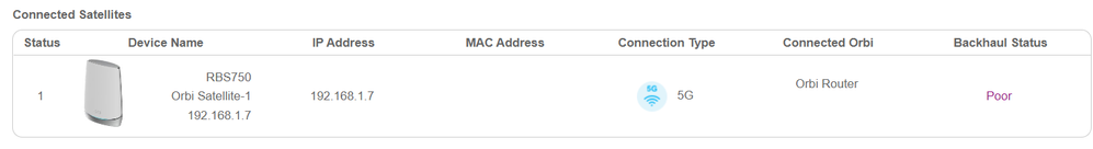

And here's the weird thing - I don't have ANY of the satellites plugged in or turned on but my netgear login to router page shows this:
How can I have a satellite connected when none are plugged in?

- CrimpOnAug 15, 2022Guru - Experienced User
It depends on how it has been since the satellite was powered off. We humans expect computers to react instantly, but the Orbi router maintains the device list by periodically scanning the network. It is really frustrating (to me) when I open the Orbi Attached Devices page to see that my phone is connected at 2.4G to a satellite in the garage when it is actually connected at 5G to the router which is sitting next to my desktop computer. (At least that's what the phone says.) Sure enough, in 10-15 minutes, the Attached Devices display shows the phone is connected at 5G to the router.
My guess is that it is the previous satellites that need to be Factory Reset. When they left the factory, they had been paired with the router so that customers could unbox everything, set them up, and use them without configuring anything. Now that router has disappeared, so they need to have that old configuration cleared out so that they are open to pairing with a new router.

Yes, I know we can be impatient sometimes... 😉
I performed a "factory reset" (using a paperclip in the "reset" location) on all units - RBR, new RBS, both previous RBS, with no luck. RBR still cannot "find" either of the two satellites. And the "Attached Devices" still shows this RBS. 🤷🏻♀️
