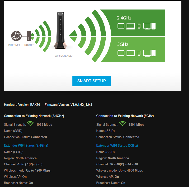

- FURRYe38Dec 23, 2020Guru - Experienced User
FYI, NGs EAX80 does connect and work with Orbi AX:
