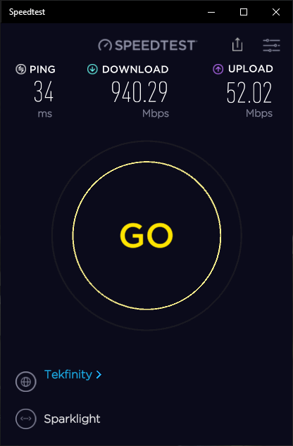

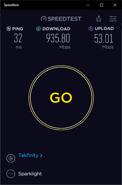

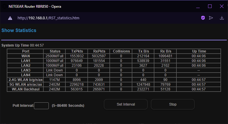

I just put my 850 back online at main home router. Connected the RBR first and setup it up.
CAX80 in modem only mode. Rebooted when RBR was turned ON and connected.
Manual channels 1 and 40. 100% power output. WMM enabled on both radios, CTS at 64 and AX mode enabled on both radios. I may disable AX mode on 2.4Ghz since I don't have anything that uses AX mode on 2.4Ghz.
Armor not enabled and already expired on Orbi app.
Traffic Meter enabled and set to None.
No SPC seen on Orbi app. Yet.
After RBR was online and up and running, I turned on each RBS while in same room as RBR one at a time. I noticed that the RBRs web page reported the RBS initially as being wired, when I had NOT connected them via ethernet. Odd behavior seen here. After RBS were connected wirelessly, I set a IP addres reservation for each at .149 and .150. My DHCP is 192.168.0.1 and range is .100 to .150. After IPs were reserved. I powered OFF The RBS and place them in there remote locations. Powered them on 1 at a time. Both are ONLINE and both reading 5G wireless on the RBRs web page and wireless in Orbi app. Both RBS show connected devices as well as the Orbi app showing same. Though "unknown" devices are seen on the RBS web pages. :smileyfrustrated:
Wired PC connected to RBR speeds:
WIreless Speed with a ASUS GT-AX11000 in wireles bridge mode connected to a RBS:
RBR Onboard speed test results:
Going to leave this run for a few days.
