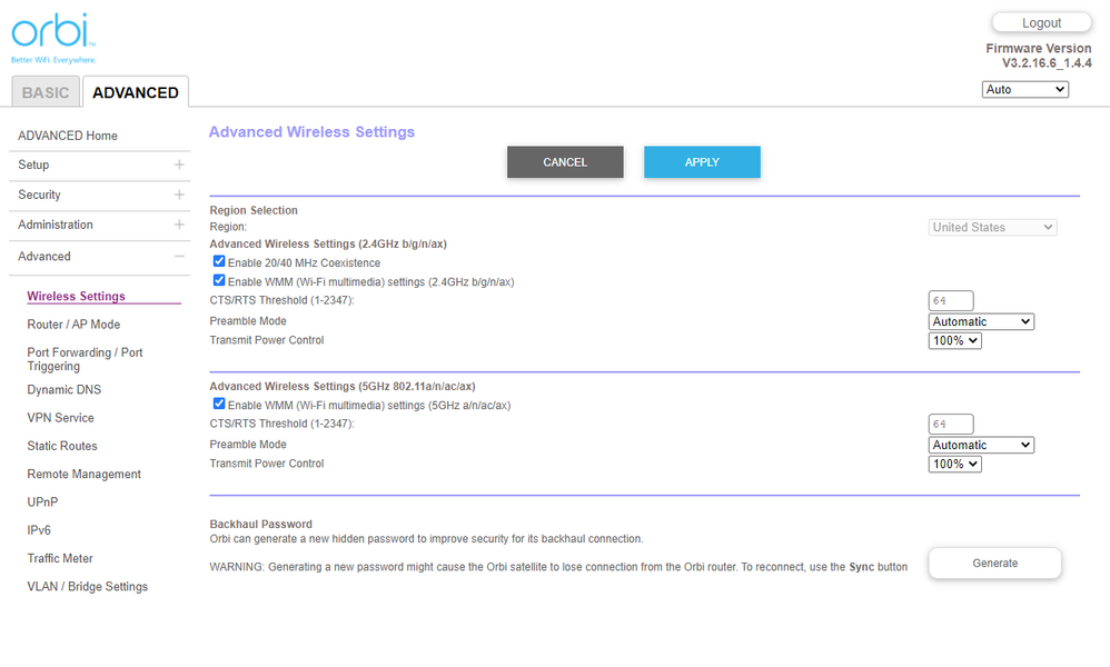

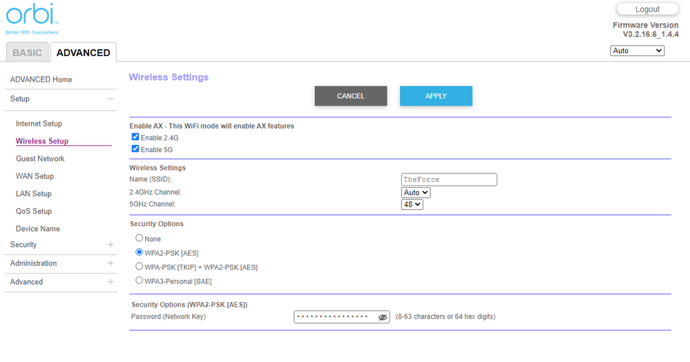

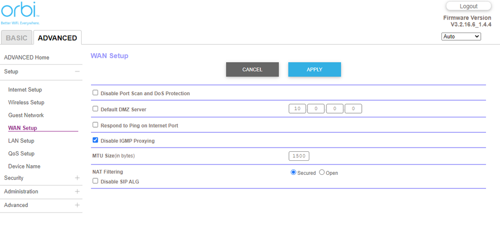

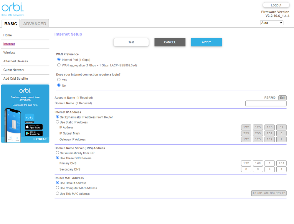

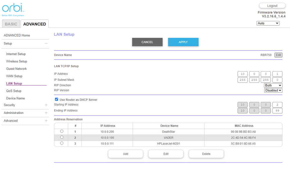

  • Who is your ISP? Is your ISP modem a modem only or modem/router?
    Can you screenshoot your Orbi settings and post them, or at least post your LAN, WAN and wireless settings? Is the system in router mode or AP? The gaming issues could be your settings.

      My ISP is AT&T, I have 1Gb Fiber service. The Modem is a Pace 5268AC. It is a modem/router which does not have the option to be placed in bridged mode. The best I could do was to disable as many services as I could, connect the Orbi to it and then set the Orbi to the DMZ. The orbi is giving out a 10.0.0.x address, the Pace is 192.168.1.x. If this NIC issue is not related to the Orbi, it would be a HUGE coincidence that it would start to fail as soon as I setup the Orbi.
