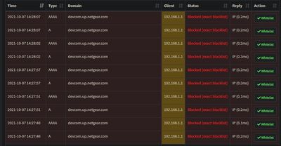

So in order to see what my RBR750 router communicates with, I have installed a pi-hole DNS server and configured the router to use this server for all DNS related needs
This is the log from the pi-hole:
and the amount of requests is huge
the only two sites I have seen being accessed by the router are
- devcom.up.netgear.com
- www.netgear.com
Next thing will be to downgrade the firmware on the router / satellites and see if the router is able to perform the automatic upgrade. If not, at least there is a good way to prevent the upgrades
- www.netgear.com
- vadimdr123Oct 07, 2021Guide
Added these as well, but have never seen the router accessing these sites. The only two being access from the statistics of the last 7 days are the ones I listed
- FURRYe38Oct 07, 2021Guru - Experienced User
If you block those, go to the FW update check under Advanced tab/Admin and select Check for updates. The status should return Service Unreachable if it's blocked correctly upstream.
Just did it.
The router was trying to access
- a1599er83nvyl8.iot.us-west-2.amazonaws.com
The second one was reachable, but the router still says that
Got it, attached the image to the previous post. The status was as expected - "Service unreachable"
What do you see there if you remove
from being blocked while leaving the
http.fw.updates1.netgear.com
updates1.netgear.com blocked?
Here you go:
- The router showed "Update failed"
- The satellites showed "No New Firmware Available"
The screenshot from the pi-hole is attached
Ok so this works, tried on my RBR850 use these addresses blocked on a upstream router. I get "Service Not Reachable" message.
But RBR still works for internet services. :smileywink:
vadimdr123 wrote:
Just did it.
- vadimdr123Oct 07, 2021GuideThis is great, so it actually means only one domain should be blocked and it prevents the router and the satellites from being able to access the firmware updates.
