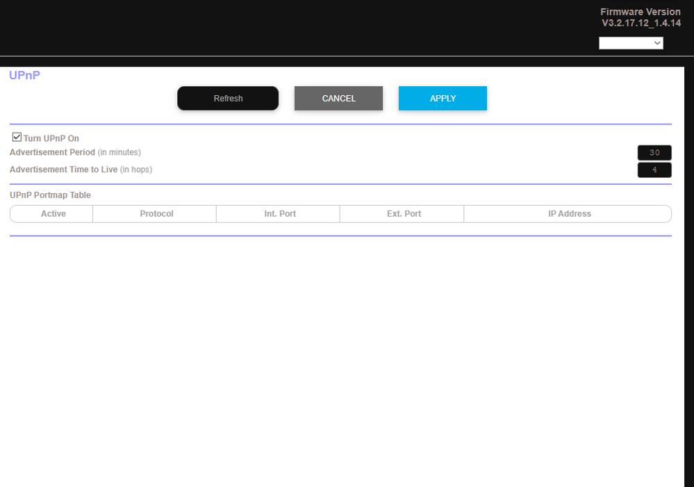

Note that I found other reports that the UPnP portmap table has/had glitches (https://forum.netduma.com/topic/28845-xr500-upnp-portmap-table-is-not-refreshing/): is one of you in position to confirm that they can see an UPnP entry listed on the portmap table in the Advanced menu! I wouldn't like to reactivate the feature without being sure that "it works for other users".

I have uPnP enabled on my RBR however I also see the UI is no populating with any display of port and device information. I believe its working as I game with this router with two xbox consoles and have not seen any issues.
Sounds like we need to make contact with NG support about this UI issue.

Quick update: my issues have disappeared since I disabled uPnP.
The uPnP seems buggy: it affected manual port forward rules and its does not properly document the uPnP port mapping table that stays empty.
I recommend disabling uPnP to avoid the issues.

There are two prolems with the uPnP implementation of the Orbix AX6000:
1/ it breaks my managed port forward rules (although the uPnP devices are not issuing requests related to the same ports): they stop functining as soon as a uPnP request arrives. This took quite a while to dagnise!
2/ the uPnP request are "mentionned" (without details) in the log of the router, ...but the uPnP port mapping table is not displaying anything. It stays empty. Many users (even the ones with uPnP-only, ...and for which it apparently work) also report not seeing the mapping in the router console. So this seems a general issue.
- FURRYe38Mar 13, 2021Guru - Experienced User
Flupke wrote:There are two prolems with the uPnP implementation of the Orbix AX6000:
When any manual PF configurations are configured, uPnP needsd to be disabled when manual configuration are used. This has been a known thing across all routers. This isn't a bug. Just a configuration thing.
2/ the uPnP request are "mentionned" (without details) in the log of the router, ...but the uPnP port mapping table is not displaying anything. It stays empty. Many users (even the ones with uPnP-only, ...and for which it apparently work) also report not seeing the mapping in the router console. So this seems a general issue. Yes, we've reported this to NG regarding nothing being displayed in the UI.
