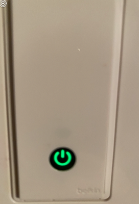

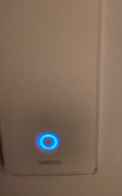

Firmware Version
V3.2.17.12_1.4.141-11 channels are under 2.4 GHZ. was set on default to "auto".
Also wanted to give details on my setup for others:
Fios ONT directly into orbi (RBR750) via an ethernet port (No Fios router). 80 total attached devices to 1 orbi router and two satellites. (I know Orbi advertises this model can only handle 60+ I believe which was also concern for me.
40 Wemo none dimmable switches. Of which 20 are the newest model and 20 are one version behind (pictures are attached). Whats interesting is that only new model wemo switches would go into a reboot cycle. Older models (on the left) would all stay online. The difference between wemo models are older version on the right do not have apple home kid functionality and are connected to a wemo bridge.
I got logs from the reboots , sorted them and found few IPs and their attached mac addresses which were restarting. Both devices I was monitoring kept getting the same IP. So there was no point trying to get static assignment to them to see if it resolves the issue. I did it anyway and it did not help. Was driving me insane. My wife was giving me the look like I don't know what I am doing with all the switches going offline. As soon as I switched the channel to 40 and later tried 44 , all devices came back online without further robots. Thanks again.
