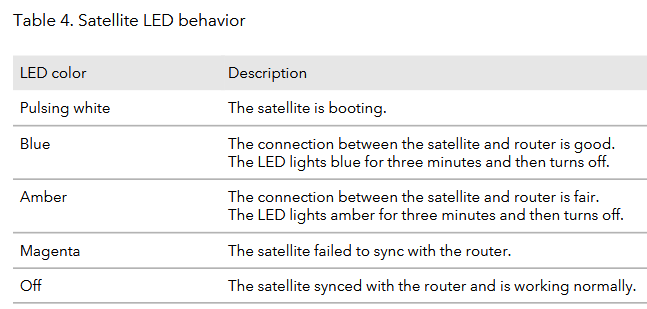

I want some clarification on the sync button though. I press the button enough to feel it click, and as I said, the LED on the front begins pulsing white. Is that a sign that it is working or do I need to hold it down for 5 seconds? Is there a difference?- CrimpOnDec 02, 2024Guru - Experienced User
From page 12 of the User Manual:
https://www.downloads.netgear.com/files/GDC/RBK852/RBK852_UM_EN.pdf
