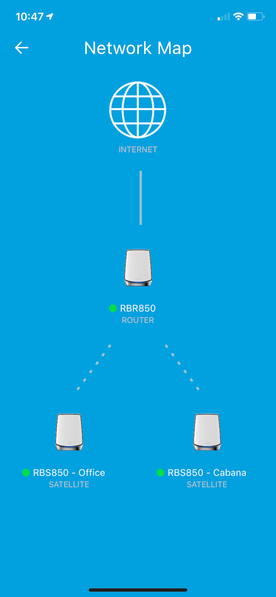

- Rogelio1May 13, 2020ApprenticeSo I went back and looked at the network map and it has reverted back to having each satellite connect to the router and disregard the prior daisy chain. Nothing was rebooted or reset.
Not having much confidence in this AX orbi’s firmware logic. AC Orbi always locked in on daisy chain and never reverted back when the topology setting was checked.- FURRYe38May 13, 2020Guru - Experienced User
Possible the app maybe changing status and not the actual system or RBS. If nothing rebooted. The RBS maybe still be daisy chained.

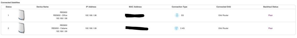

App is showing backhaul as good. Web login shows it as poor. When I set everything up initially, backhaul was "good" in the web browser for the two satellites (why it's suddenly "poor" is a mystery to me -- the office satellite is like 50 feet away with out closed doors or many walls in the way. Also now shows sat 2 (furthest away / cabana) as being on 2.4Ghz which leads me to believe it is in fact connecting back to the router on 2.4Ghz (instead of 5Ghz chained to the other sat)
