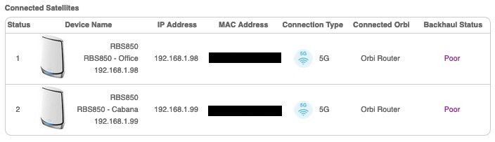

Just bought the 3 pack (1 AX6000 router and 2 satellites), and as far as I can tell there is NO ability to enable daisy chain topology. Here is the old (original orbi) settings for adanced wirele...
Rogelio1
May 13, 2020Apprentice
So I went back and looked at the network map and it has reverted back to having each satellite connect to the router and disregard the prior daisy chain. Nothing was rebooted or reset.
Not having much confidence in this AX orbi’s firmware logic. AC Orbi always locked in on daisy chain and never reverted back when the topology setting was checked.

App is showing backhaul as good. Web login shows it as poor. When I set everything up initially, backhaul was "good" in the web browser for the two satellites (why it's suddenly "poor" is a mystery to me -- the office satellite is like 50 feet away with out closed doors or many walls in the way. Also now shows sat 2 (furthest away / cabana) as being on 2.4Ghz which leads me to believe it is in fact connecting back to the router on 2.4Ghz (instead of 5Ghz chained to the other sat)

Now it shows that my satellite in the shed/cabana is connected at 5Ghz to the router (which makes even less sense... I would expect it to either connect at 5Ghz to the other sat, or connect at 2.4Ghz to the router (not ideal, but at least some logic there).
29 days left to see if this Orbi can sort itself out. I can't imagine any setting (of which there really are none) will change its logic on 2.4 vs 5Ghz / daisy chain other than a firmware update. So far I'm unimpressed with how it's handling a second sat and think its firmware is likely still very buggy.
