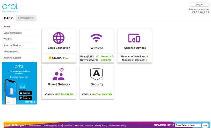

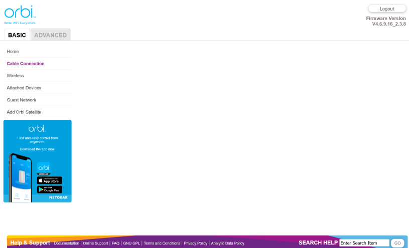

So after having an issue that was resolved. I found out that I have another issue. When I went to Cable Connection on my CBR750 it shows no information. See attached photo. I've had my ISP resend the...

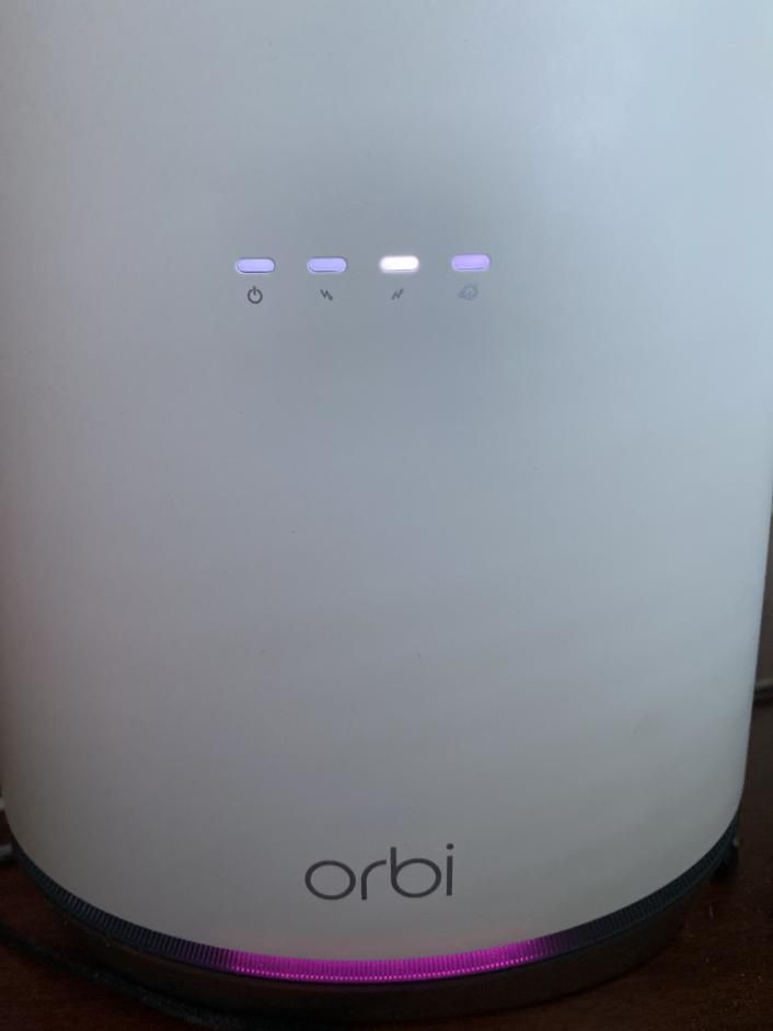

1. Factory reset seems to cause incorrect LED behavior seen on the front panel. The power LED is not enabled while only the uplink LED is ON.

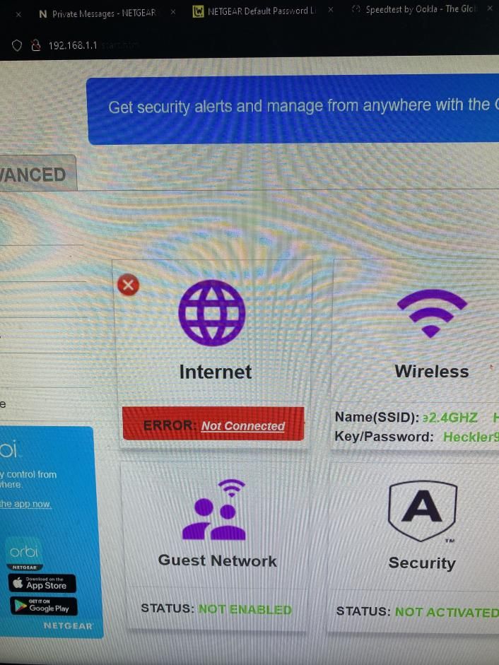

2. After the factory reset (Button Press and Erase button on web page UI), the PC doesn't seem to get a IP address correctly. User can set a static IP on the wired PC and seems to gain access to the CBRs web page at this point.
3. When the user can skip the setup wizard and manually setup the CBR, the home page reports No Internet Connection even though the coax is connected.
4. The user can load a saved backup from file and this returns the CBR to operation and internet services are restored however the Internet Connection status reports POOR. We can't troubleshoot this unless we see the Cable Connection and Event Logs pages where are not available on this unit or seen in any browser tried.

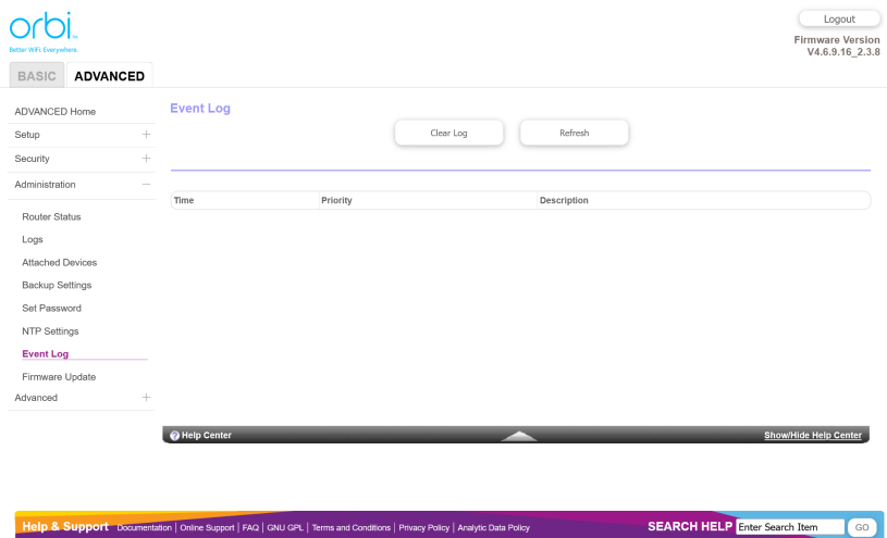

5. Cable Connections and Event Log pages are displaying blank or no information from the modem side. (I believe this is the root or initial problem that a factory reset doesn't seem to fix.)
I believe there is a problem at the modem side or between the modem and the router side UI that's not getting the status and log information from the modem correctly. The CBR is in some bad state here and a reset doesn't resolve it.
