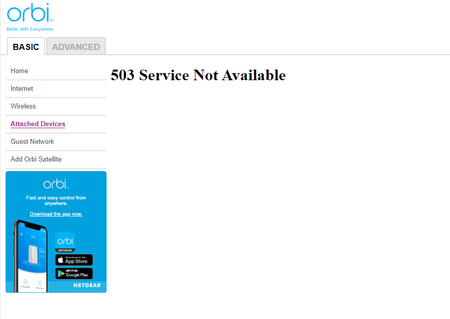

No longer showing attached devices after firmware updated to 7.2.6.21
Please help.

ReLFrEoD
Feb 05, 2024Aspirant
Same results with different browsers. Router is restarted several times. This is a setup that includes two RBKE963 kits and eight RBSE960s. The second router is in AP mode and has a wired backhaul. Four of the satellites have wired backhaul installed. This is a 40,000 square foot commercial site. There are up to 200 devices connected to the network. Everything seems to be working, but I can't see any attached devices...
