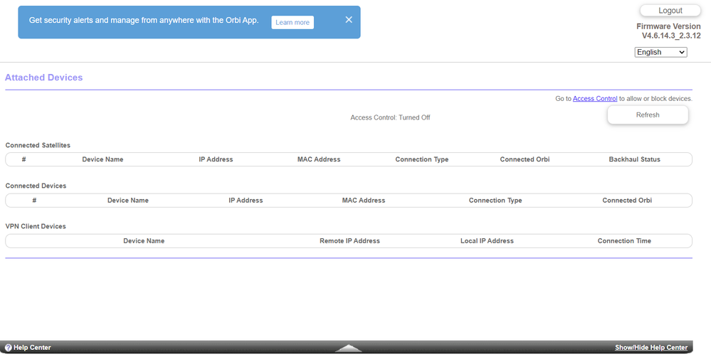

NO satellites and NO devices ever load on the web GUI
I am having exactly the same problem.  Has been working without issue.  However now, NO satellites and NO devices ever load on the web GUI.  No issues seeing devices from the phone app.

      Since the phone app correctly shows all the connected devices in the router, that rules out any hardware that could prevent the devices from displaying correctly in the GUI.  Issue is the web page fails to load the content for the connected devices.  All other areas in the GUI displays as it should.
