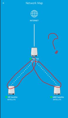

Devices have trouble connecting to the closest router/satellite. As aresult the performance of some devices are poor, e.g. alram system, security cameras, doorbell cameras, Roku, garage door openers,...

2. the device is the one who chooses whether to be connected to the satellite versus the router. its the devices own roaming/connection protocol that determines that. A few things can impact it such as distance/obstructions/interference
3. the dotted vs dashed line? When its a solid line, its indicating the satellite is hardwired to the router. When its dashed, its indicating its connected to the router using the wireless backhaul. Did you have the satellites hardwired in at some point but not anymore?
