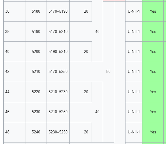

    To start with, WiFi "channels" have specific radio frequencies.  Wikipedia has a nice description: https://en.wikipedia.org/wiki/List_of_WLAN_channels#5_GHz_(802.11a/h/j/n/ac/ax)
    Here's what it says about channels 36-48 that can be selected in the Orbi app:
    The green "Yes" indicates that these channels are available to use in the United States.  (The article lists regulations in most parts of the world.)
    Notice that each separate channel does overlap with the channel next to it, but those channels are not listed in the pull down menu to be selected in the settings menu.  i.e. only 36, 40, 44, 48 can be chosen and none of them overlap with each other.
