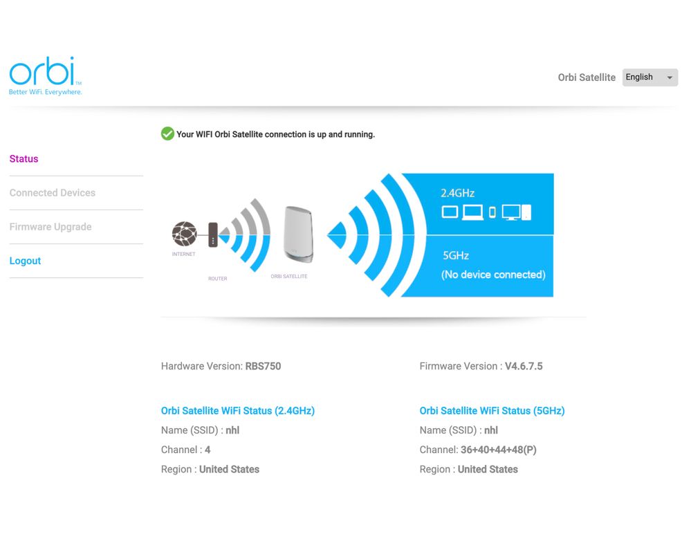

- RBS750 (Satelite) - Currently on "Official" beta release, link provided by FURRYe38 ( https://community.netgear.com/t5/Orbi-WiFi-6-AX-and-WiFi-6E-AXE/New-RBR750-RBS750-Firmware-Version-v4-6-7-5-Released/m-p/2182131#M25411 )

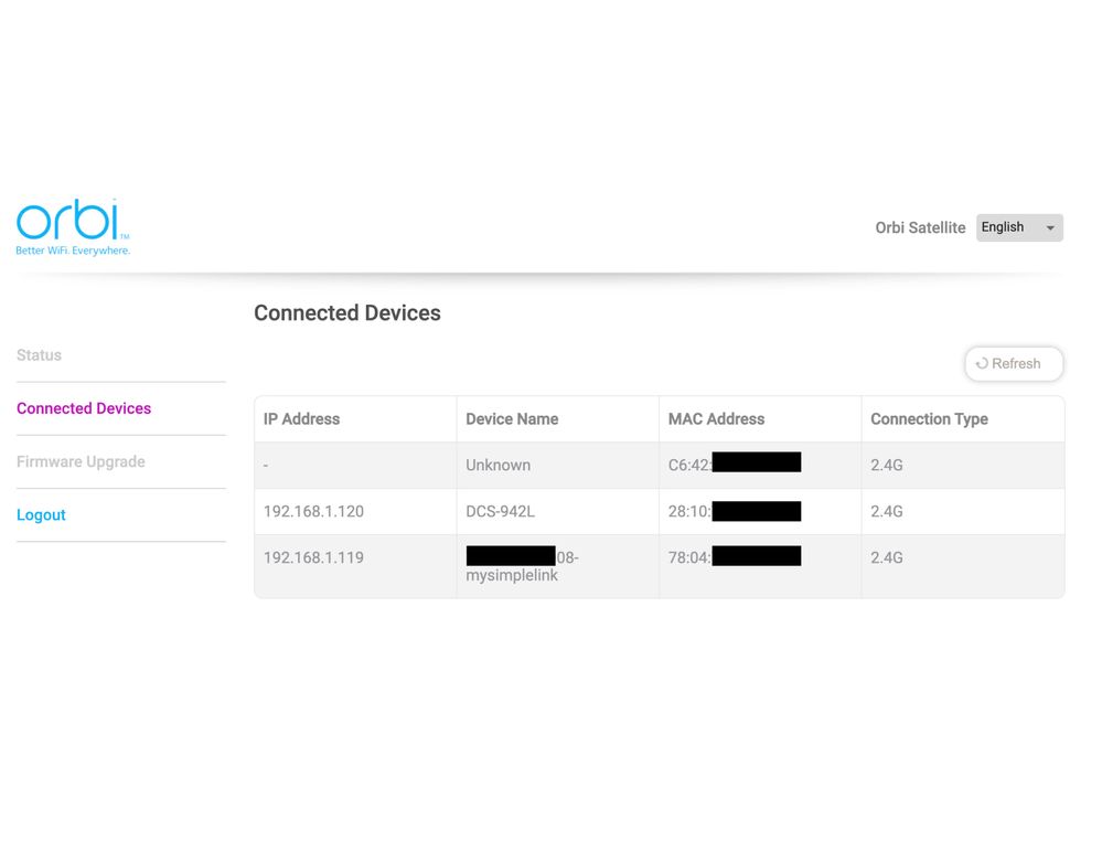

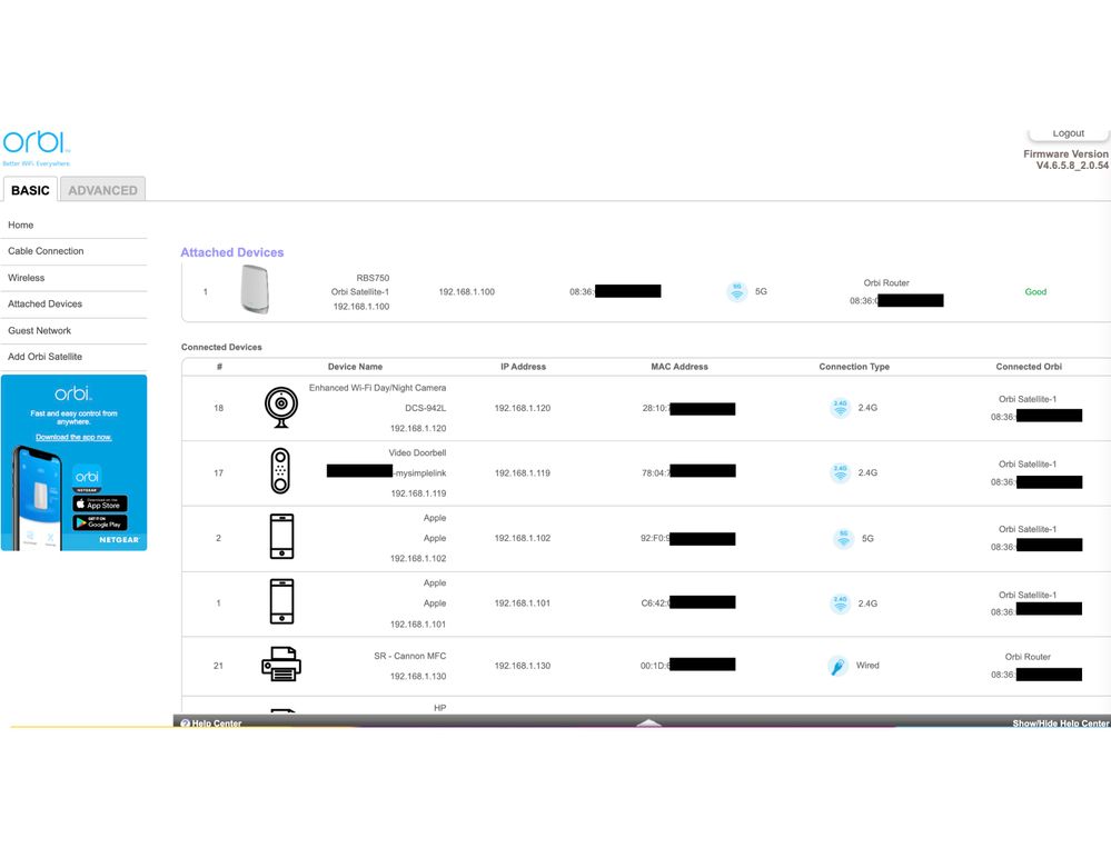

In my 2 story, 2600 sq. ft home, have about 30 WiFi devices, mix of 5Ghz, 2.4Ghz (and about 20 Zwave (908.42 Mhz) - ZWave just FYI and not relevant for this discussion). Some of the WiFi devices are "static" devices, in close proximity to the Satelite, and should connect to the Satelite. They randomly keep "bouncing" between the Router and Satelite, leading to a very unstable network!!!
I am attaching a few screen shots.
