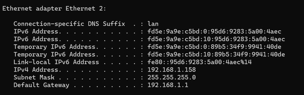

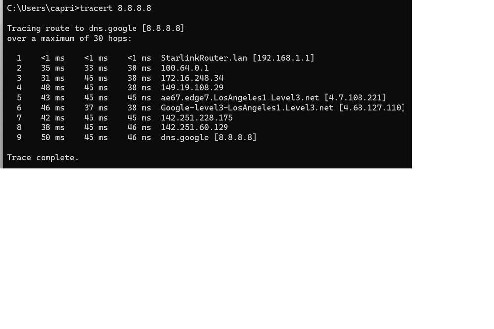

Here's a picture of the IP address with ipconfig cmd being run in Windows 11 Cmd line, followed by tracert to Google's DNS 8.8.8.8
Web pages load fine from the laptop directly connected to Starlink Ethernet
The problems begin when I insert Orbi into the loop.

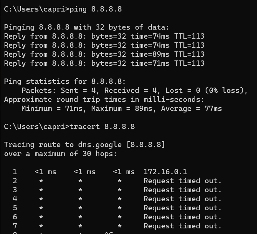

When using Dynamic IP and regardless of whether I select Google DNS 8.8.8.8 or not, I don't get full access to the Internet through the Orbi. However ping works fine through the Orbi to Starlink, but not with network translation of websites, eg only IP addresses work, not for example www.yahoo.com.
Tracert does not work at all with IP addresses through the Orbi.

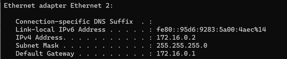

Here you can see ipconfig on Windows shows Orbi is giving my laptop an address of 172.16.0.2 and the gateway for Orbi is 172.16.0.1. And Tracert doesn't work.Static IP configuration makes no difference on Orbi, still the same issue.

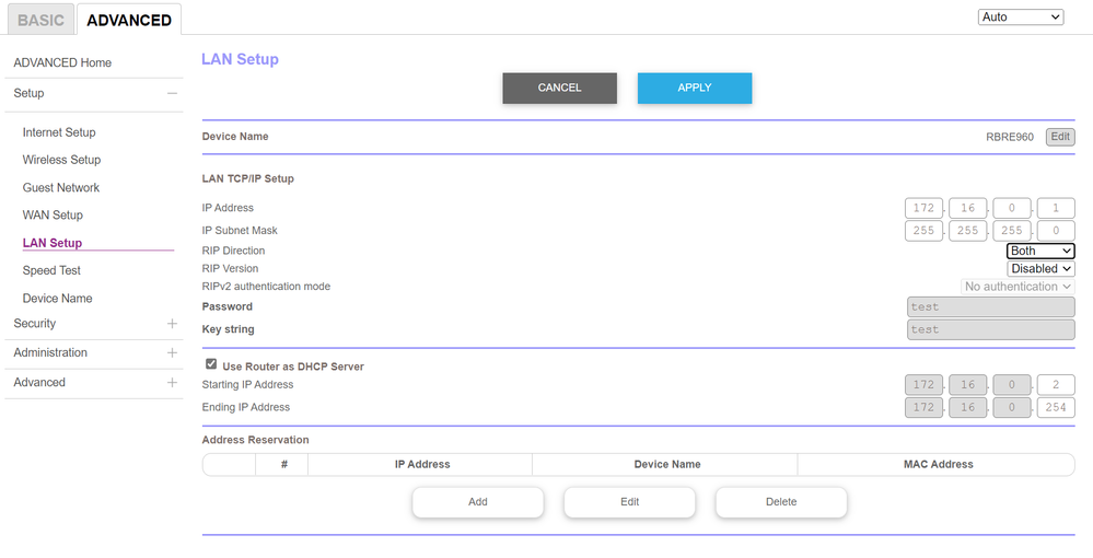

Your suspension may be correct. When I setup my Orbi it recognized that Starlink was using it's default address range and Orbi switched to 10.0.0.0/24. Possibly you need to manually update Orbi to use another range if not occurring automatically.
