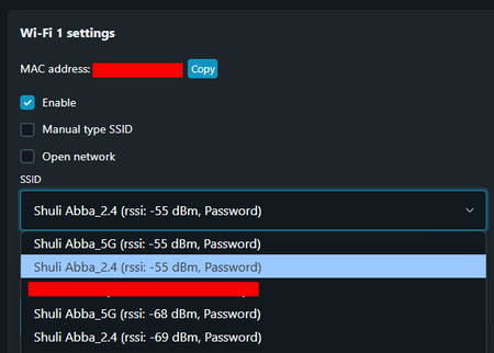

Hey Guys, I have the Orbi RBR750 + 1 Satellite. The setup is in AP mode since I have a FW as GW. I can see my all of my devices and everything works perfectly, except - I connected a Shelly ...

It goes like this: ISP GPON > Forti FW WAN.
Forti FW LAN > Orbi R Internet port > Orbi S LAN port.
another port in the Orbi R goes to my HP switch where I have all the wired devices connected to.
