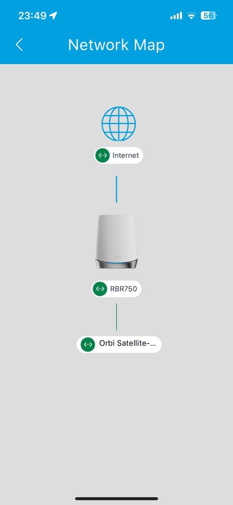

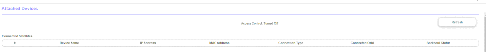

2. On the Orbi app I see that the satellite is connected, but on the web management console, it is not recognized. see attached screenshots.
