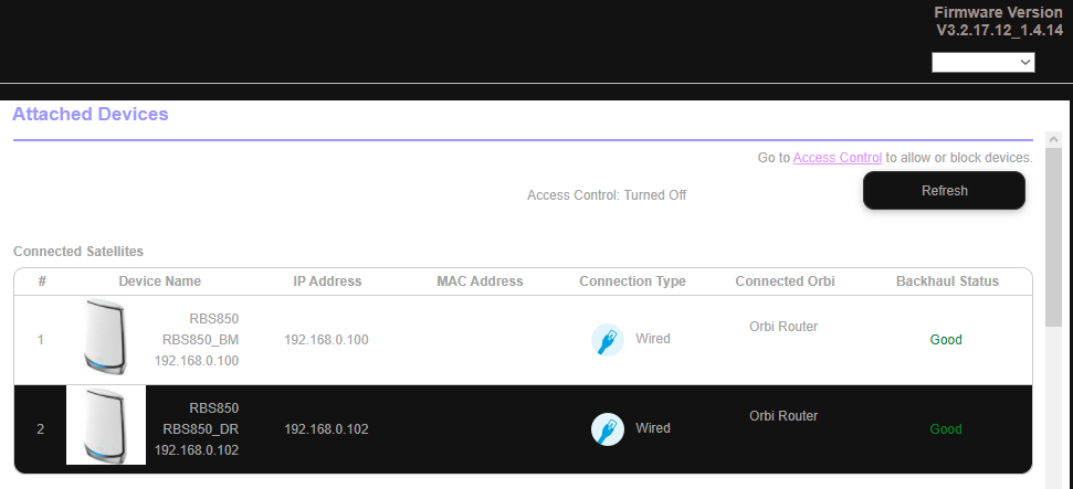

So take a RBS to the same room or near the RBR and use a LAN patch cable and wireless sync the RBS to the RBR, the after that, connect the RBS to the RBR. It should sync correctly and check the RBS satus page. Let us know if this happens.
My two are fully wired:
- theguptasMar 31, 2021Guide
Ok. Will give that a shot. Btw, are your satelllites wired directly to the router ie star topology or are going via a switch ?
