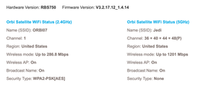

Orbi 753 unencrypted 5ghz network even though WPA2 security is turned on
Hi Everyone, I have searched through the forum and seen other people have similar issues but briefly 1) RBK753, satellites setup with ethernet backhaul, router running in AP mode 2) from day 1...

I have 1 RBS. I checked it after 1 or 2 minutes. But the RBS has been running for some time now, 30mins, with ethernet backhaul directly connected to the RBR Lan port. It's still reporting no security on 5GHZ.

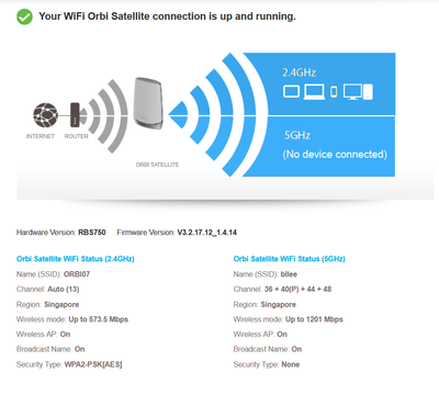

Okay, I actually powered off and on the RBS after factory reset, and i'm able to sync it up successfully in wireless mode. I did the wireless sync up, then cable patch in Router mode. Subsequently, I switched it to AP mode. I did not remove the RBS as a device in the attached list. It was able to sync in wireless mode. I then did a cable patch between the RBR and RBS beside each other. The sync worked.
Now when I placed RBS at the other end of the house with direct connection to the lan port of the RBR, it's able to sync as well. The security settings is correct.
Oh my god, I think this device and its firmware is clearly not a finished product. But I'm glad that it's working now. Though, I still wonder if this was because of a defect in either the RBS or RBR.
This time round, I did the setup on the ios mobile app except for when changing the region to Singapore and switching to AP mode from Router mode.
Hope this helps anyone else that's facing the same issue.
