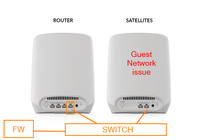

RBR connected with RBS via TP-Link TL-SG116 switch as follows:
During my tests in Router Mode and then in AP Mode I understood that issue with Guest Network on the Satellite only occurs when RBR (in AP Mode) connected to the switch via Enternet port (marked with yellow).

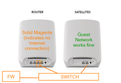

In case RBR (in AP Mode) connected to the switch via one of its LAN ports - Guest Network on the Satellite works well. Only RBR's ring LED indicates "Solid Magenta", what means "Your Orbi has no Internet connection" and also it occupies one LAN port:
