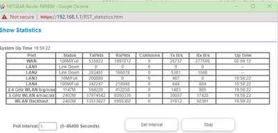

Have you logged into the orbi to check its wan port statistics?
I've seen sketchy cables that'll connect at 1 gig on some devices an only 100mbps on others.
https://kb.netgear.com/24222/How-do-I-display-Internet-port-statistics-on-my-Nighthawk-router
(this is for nighthawk but will work on orbi too)

Thanks for that. I just did and see this:
Not sure why WAN is showing 100M/Full though.
