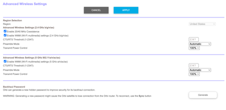

Orbi 850 how to add 2.4ghz device?
I have a device that only connects to 2.4 Ghz. I found the discussion linked below and followed the instructions.. however the instructions to "Uncheck the box "Broadcast SSID on 5G Channel" does not...
CrimpOn
Dec 16, 2022Guru - Experienced User
You are correct. The original Orbi ac products had an option to enable/disable broadcasting the SSID on both the 2.4G WiFi and 5G WiFi channels (and still do!) This option was helpful in those rare cases when devices were difficult to connect. The newer AX product never offered that option.
My experience has been that the vast majority of Internet of Things (IoT) devices that SCREAM OUT, "MUST have 2.4G WiFi" will connect just fine provided that the user just opens the smartphone app and follows the directions, ignoring all that 2.4G paranoia. I have connected over a dozen brands of smart plugs, cameras, and other gizmos and had only one that required a workaround.
The gist of the problem is that the smartphone app is poorly written Either the app discovers that the phone is connected to the house WiFi at 5G and obstinately refuses to proceed, or the app tries to push the MAC address of the 5G WiFi channel to the gizmo when what it should be doing is simply providing the SSID and password.
