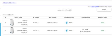

the screen image I tried to post showed the offending satellite as having an IP address, a MAC address, a wired connection and a "good" backhaul status. The satellite that is working shows the MAC address of the router in addition to the information above.

- tjtrimbleNov 14, 2021Luminary
I have the same issue and its an issue with the V4 firmware. I have found the 2nd wired satellite actually works, even though the app/web interface doesn't show that it does. Try logging into the problem satellite directly via its IP address. It should show the connected devices. I am hoping Netgear releases updated firmware to fix this issue since I never had these issues on the V3 firmwre.
