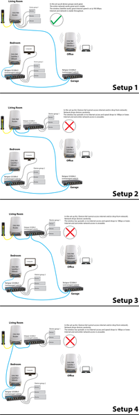

Orbi 960, adding switch and network failure
Hi all, Info: Orbi 960 router and 2 satellites. Firmware 7.6.31_5.0.24 Cat 5e cables throughout. Netgear GS308v3 unmanaged switches Motorola MB8611 Cable modem I have factory reset every...

Hi,
Thanks for looking over the post and the problem.
I did try with switching out to just using the 1 gigabit ports (avoiding the 2.5 ports on the router and the wired satellite). It still presents the same issue: devices on the switch are not seen, wireless and wired internet comes to a literal stop.
I'm wondering at this point if something is wrong with the way the router is transmitting from its ports? I just don't know.
As mentioned when I revert the setup back to Setup 1, everything is rock solid and fast, but I'm out of ports for any new wired devices.

- CrimpOnJun 26, 2024Guru - Experienced User
Looking at the network pictures again, it seems that adding the 3rd switch (connecting router and 3 devices) is the common denominator for all failed configurations. I wonder if this switch (a) is a lemon, or (b) has a wiring issue (bent pins?) that is causing network loops. What about:
- Temporarily break the connection from router to the rest of the network, and
- Swap one of the other switches to place between the router and nearby devices.
I have used both Netgear and TP-Link unmanaged switches exactly as shown for years. These are so inexpensive that it might be worth spending $25 to get another GS-308 (or equivalent).
- norbertsfJun 27, 2024Aspirant
I have already tried those 2 suggestions and the issue still occurs.
1. I tried just running a long ethernet cable from the Orbi Router to an Orbi satellite (so hardwiring it) with no switches on the network. As soon as I add any switch to the Orbi Router ports (2.5 port, 1gig port) the system issue rears its head
2. I tried swapping out the Netgear GS308 for a Netgear GS116 (6 port unmanaged) and a D-Link 16 port DGS-1016D (this one allows turning off EEE), and still same issue.
