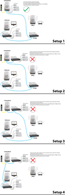

Orbi 960, adding switch and network failure
 Hi all,     Info:  Orbi 960 router and 2 satellites.  Firmware 7.6.31_5.0.24  Cat 5e cables throughout.  Netgear GS308v3 unmanaged switches  Motorola MB8611 Cable modem     I have factory reset every...
- Jul 01, 2024Guys thanks for the help on this. So 2 things. 1. I switched out cable connecting router to the Netgear 16 Port switch, and am now getting 945Mbps, Network solid (wired and wireless). 2. I continued attaching ethernet devices to the switch and apparently my Airport Express 1st Gen was the cause of the network failure. I am going to have to figure out how to set this up or give up on it. ( I used to use it for Apple Airplay - music streaming). It may be more trouble than it is worth.

norbertsf wrote:
As soon as I add any switch to the Orbi Router ports (2.5 port, 1gig port) the system issue rears its head
Thanks for describing the switch substitutions. Can you also clarify one other point:
Does "as soon as" include connecting the switch by itself (no devices connected to the switch)?
Adding the switch requires one additional Ethernet cable. Tried more than one cable?
What sort of devices are connected to the router?
So 2 things.
- FURRYe38Jul 01, 2024Guru - Experienced UserGlad that was all. I haven't used my AE in a while. Not sure if it still even works. Used for same thing. Music streaming. Only thing I did on mine back then was set it for a static IP address out side of the default DHCP IP address pool. I use .100 to .150 for my needs. Something to try. Glad you got it working. Be sure to save off a back up configuration to file for safe keeping. Saves time if a reset is needed.
