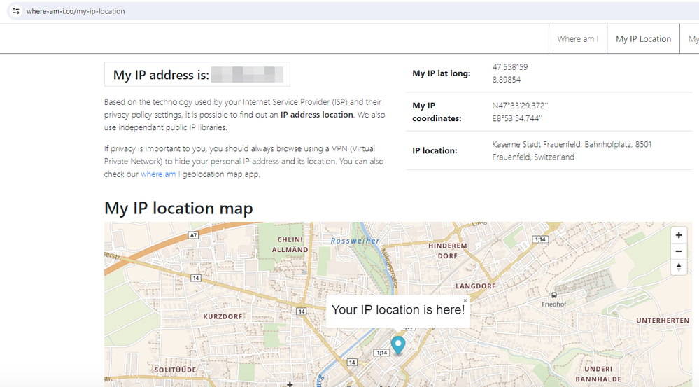

https://www.where-am-i.co/my-ip-location
https://iplocation.io/my-location
Around 100 miles from my effective, current location. At an IP address I have got assigned many moons ago. Sure, I could share my effective position from my mobile with exact GPS location allowed to my preferred browser. Wherever somebody allowed to share his position, while having that IP address assigned.
Sooo, for now the locatin for this IP is set to a place somehere the Pacific is deep enough not to find any ground. This explains how useful or useless this garbage is.
