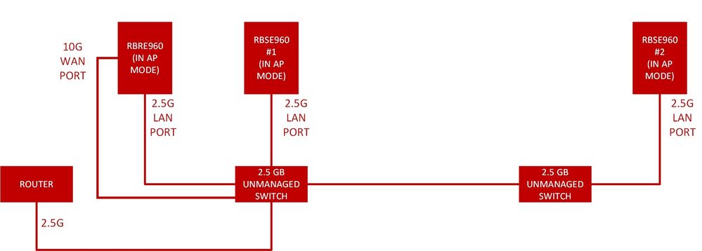

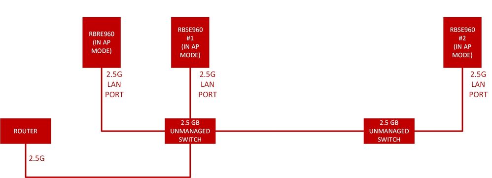

I have one RBRE960 and two RBSE960 satellites, all in Access Point mode.  I am trying to set up wired backhaul between all three through a couple of unmanaged 2.5GB switches, and it's driving me crazy.
Can someone explain to me why this works:
but this does not:
I would prefer *NOT* to have *ALL* traffic going through that first RBRE960.

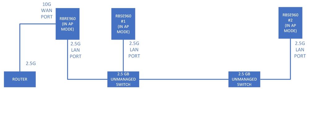

    Most simplistic response is the router manages the satellites
    Its been asked on here multiple times but it needs to go gateway---->router----->satellites/switches
    if you want it to run properly

      So "Access Point Mode" is not accurate.  It's not a true AP.
      Would this work?
      • CrimpOn's avatar
        CrimpOn
        Great diagram, thanks.
        When Netgear software engineers designed Orbi routers, the assumption was that satellites appear only on the "LAN side" of the router.  connected either:
        • over a 5G WiFi connection, or
        • through one of the LAN ports of the router
        Satellites are not found on the WAN side of the router, so the firmware does not look for satellites on that port.
        Could they have designed the product differently?  Maybe.  But they designed it this way.
        As an intellectual question:  Why does the network "seem to work", but the Orbi router has no idea what's going on with the satellites and their attached devices?
        Answer: because the wiring and switches create an Ethernet LAN subnet, every device is able to find every other device by issuing an Address Resolution Protocol (ARP) broadcast which returns the hardware MAC address of the sought device.  The Ethernet adapters/swith ports use their ARP records to say, "Oh, to reach 192.168.1.45, I send a packet out port 4 to MAC address 00:00:00:00:00:00 and it will get there."
        As plemans mentioned, this has become a frequent topic on the forum.
