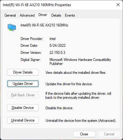

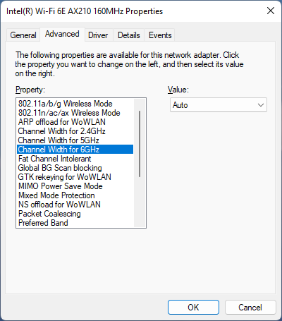

"WIFI INTEL ADAPTR AX210 6E all drivers up to date" This is a WiFi 6E supporting adapter. I have this one on one of my PCs. It does work for both Windows 10 and 11 though there was some info out there that MS didn't want to support 6E in Windows 10. Mines currently running on Windows 11.
- CrimpOnAug 14, 2022Guru - Experienced User
Thanks for the screen capture. Will be interesting to see if the OP's system displays the same information.
Could you please report the driver version number as well? (To see if his matches.)
- FURRYe38Aug 15, 2022Guru - Experienced User
This what I have currently:
