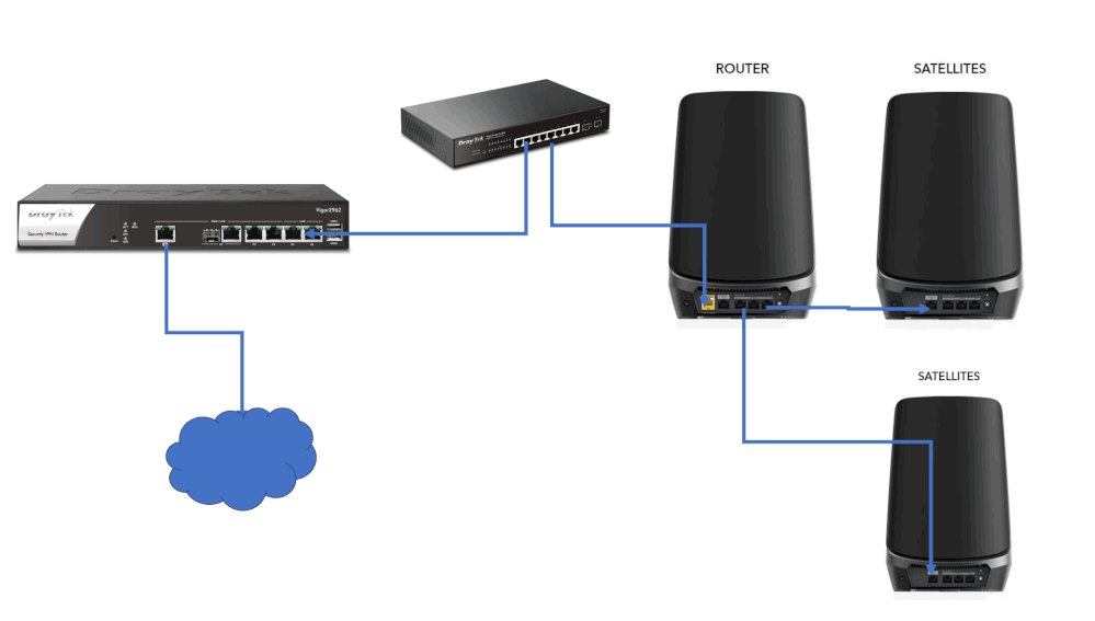

I am wondering if the addition of a switch as shown here would fix the issue as it would remain stable and powered when the router reboots. It rather depends on what the Orbi main unit is checking.

Putting a switch in between will not help.
